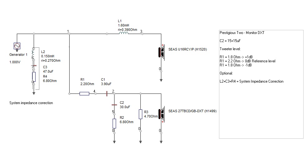

De Prestigious Two zou wel eens wat voor je kunnen zijn.
satefan
Berichten: 4124
Re: luidspreker keuze
Bericht door satefan »
Zeer fijne speakert, en de ontwerper heeft in t filter een optionele voorziening opgenomen voor buizen-liefhebbers:
The Prestigious Two – Monitor DXT uses a true symmetrical second-order Linkwitz-Riley (LR2) filter topology and has a minimalistic design approach with only one cross-over component + tweeter padding resistor in series with the driver units.
The most common way to address the driver units relative acoustic center off-set is to use asymmetrical cross-over slopes, but as in this design when using LR2 filter topologies it’s not feasible.
Other choices for dealing with the driver units relative acoustic center off-set is to use a slanted or stepped baffle as well as the use of an electrical circuit to time delay the tweeter in order to adjust the acoustical center off-set.
However, thanks to the depth of the DXT lens, the acoustical center off-set is perfectly aligned without the need for such techniques.
The mid-woofer cross-over filter section is an electrical first-order and is very simple and consists only of a large coil (L1) that shapes the cross-over slopes to a LR2 roll-off with a targeted 3kHz cross-over point. The inductor (L1) also tunes the “Baffle Step Compensation” (BSC).
The tweeter cross-over filter section consists of a single tweeter padding resistor (R1) and a first-order electrical filter (C1) that shapes the cross-over slope to a LR2 roll-off with a targeted 3kHz cross-over point. The value of (R1) can be changed to tailor the tweeter level to personal preferences.
R1 = 1.8Ohm -> +1dB
R1 = 2.2Ohm -> 0dB (Reference Tweeter Level).
R1 = 2.7Ohm -> -1dB
The tweeter is connected with reverse polarity and (C2+R2+R3) shape the tweeters frequency response and flatten the response at higher frequencies.
(L2+C3+R4) is a “System Impedance Correction Circuit” used to flatten out the impedance when using the loudspeaker with tube amplifiers. It’s optional to use this filter section and it can be omitted when using conventional amplifiers. By using this circuit the impedance is 6 Ohms, within 200-10000Hz.
http://www.audioexcite.com/?page_id=2386
