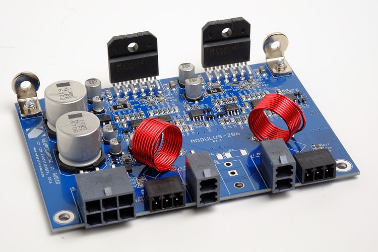

Zo knoop doorgehakt en een Modulus-286 print besteld met Power-86 voedingsprint.
Ik zal zo nu een dan een update plaatsen over de bouw van de versterker.
Hieronder alvast wat info.
Stereo: 2 × 65 W (4 Ω), 2 ×40 W (8 Ω) output power when using the Power-86 and recommended transformer.
Mono (parallel option): 100 W (4 Ω), 60 W (8 Ω) when using the Power-86 and recommended transformer.
Ultra-low 0.000068 % THD (40 W, 8 Ω, 1 kHz).
Ultra-low 0.00036 % THD+N (40 W, 8 Ω, 1 kHz).
Ideally suited for multi-channel amplification.
Excellent 96 dB isolation between channels.
Differential input with 85+ dB typ. CMRR eliminates hum and ground loop issues.
Phenomenal power supply rejection ensuring consistent, high performance even with unregulated power supplies.
Elaborate use of planes and copper pours to maximize circuit performance by minimizing supply and ground impedances.
Low-inductance signal ground connects to power ground at one point only for maximum performance.
On-board Zobel and Thiele networks for best stability even with capacitive loads.
On-board EMI/RFI input filter and ESD protection.
On-board low noise voltage regulators for the driver op-amp and DC servo.

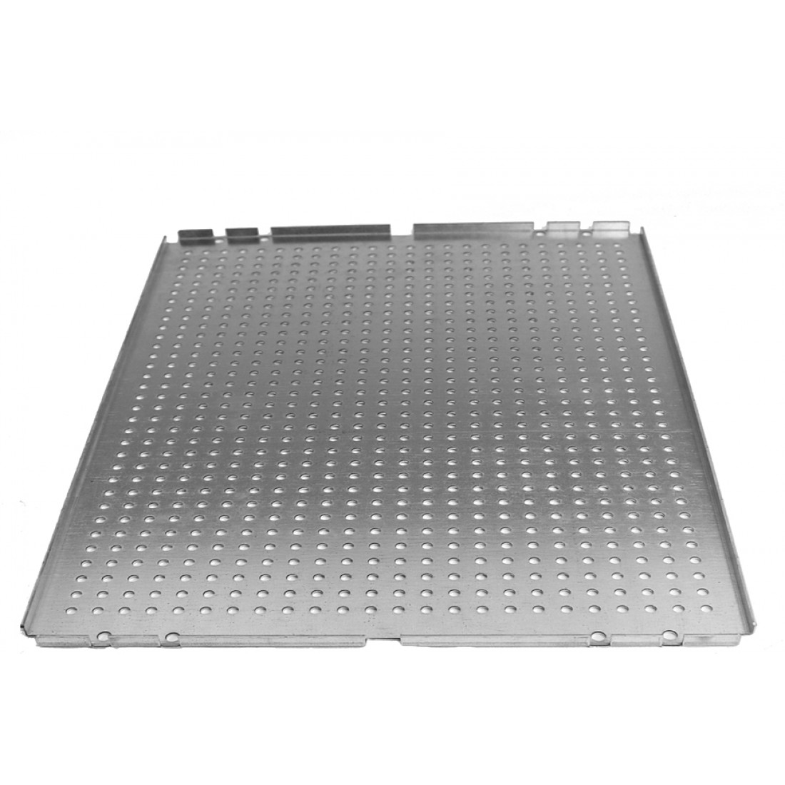

mensen ervaring met de modushop behuizingen?
twijfel nog of ik de montageplaat er in schroef of de materialen op de onderste plaat van de behuizing schroef..
vindt die plaat niet mooi
