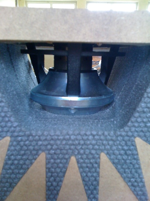

De stift is voldoende warm om te starten maar koelt tijdens het snijden sneller af dan de 80 W bout kan verwarmen.

Misschien draadje spannen en hier spanning op zetten zodat deze gaat gloeien?
Zo doen ze ook piepschuim snijden, tenminste bij Mythbusters :P

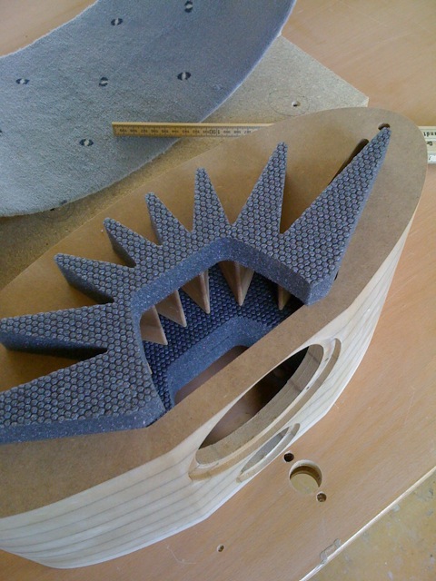

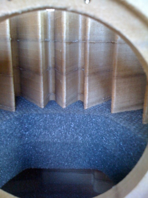

als ik dit zie krijg ik kippevel, zo strak!!!
Prachtig freeswerk heeft die duitser geleverd en ook dat Technocell is eindeloos mooi erin gebracht.

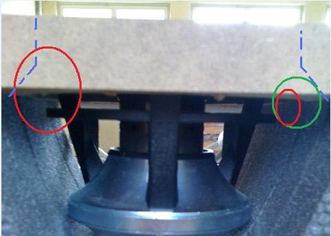

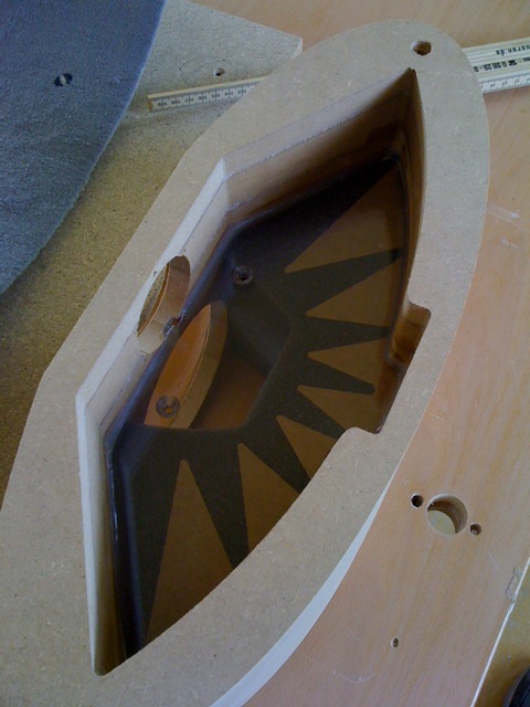

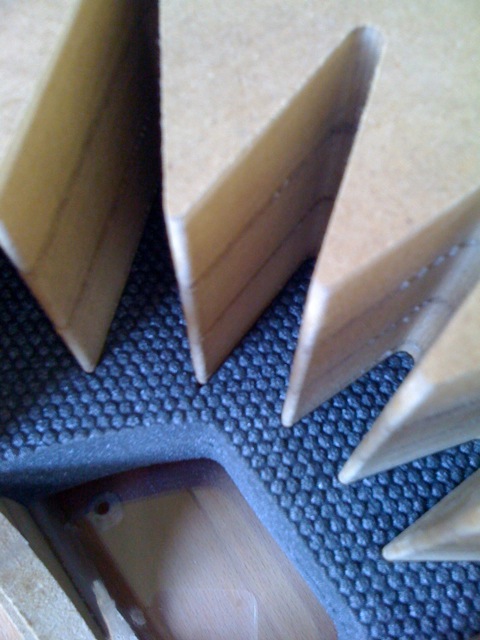

Alleen het drivergat heeft hij niet schuin geruimd zie ik net.
Zou hij vooralsnog moeten doen.
Michael, der Treiber braucht am hinterseite etwas mehr Freiraum.

heb volgende link even geleend uit een ander topic.
http://www.troelsgravesen.dk/chamfer.htm
Dit bedoelde ik dus!

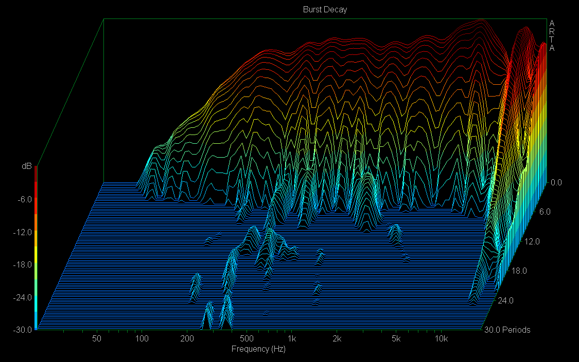

I have built the SATelite enclosure and I'd like to paste some pictures for you representing Sound Pressure Level
and Burst Decay of the Mid driver. The distance to the enclosure was 300mm for both measurements:

Welcome to the ZBA forum Mike. You make us going international!
The result seems to be quite good ... and the customised Technocell looks awefullsome ...
I personally believe that Wool will do as good (and Twaron even better) as Technocell. However the open basket design of the 12MU might be too sensitive for moisture and pieces of wool.

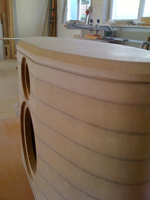

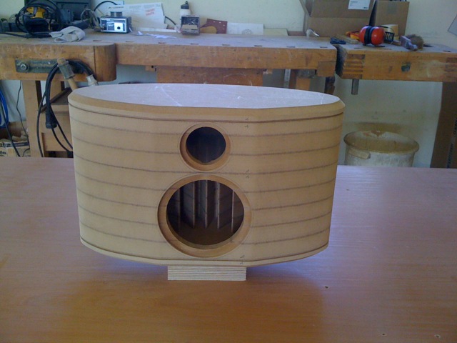

Two pictures are attached how the SATelite (designed by aster duc) looks like at the moment. I modified the
design a little bit: Did a chamfer / groove on the body. Simply take a look:
The suede coating will be Nextel: http://www.nextel-coating.com/nextel/default.asp
Probably a dark grey color. Keep ya informed.

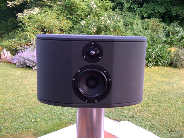

Hi,

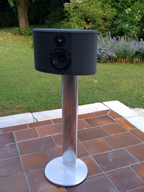

assembled one speaker today and (as promised) two pictures of the final SATelite with Nextel coating.
Will probably replace the silver screws through black ones. Not sure yet.

very nice job Mike!
The cabinets look really smooth ! :shock:

What's the product you've finished the cabinets? It looks really stealthy! Véééry nice!

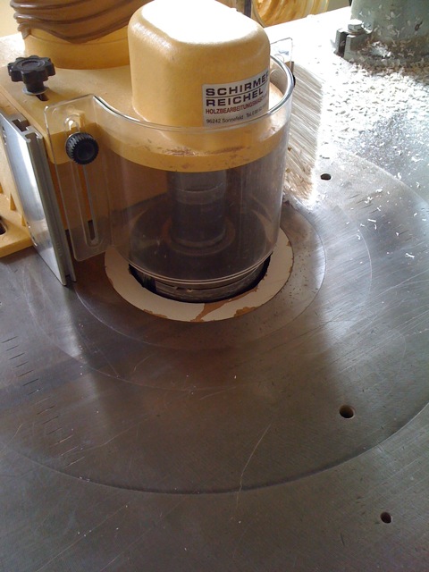

How did you make that groove?
With the router?

Hi,assembled one speaker today and (as promised) two pictures of the final SATelite with Nextel coating.
good choice Mike, they look even better now. How does the Nextel feel like, does it have a hard or soft surface? Did you spray it?
I like the silver, did mine with 'Edelstahl'. The Illuminator basket has the holes positioned in a special design. With black screws or bolds, this detail will disappear.

... glad you like it.
@aster duc: The surface feels like our TDA from Lyngdorf. Soft. Like velvet. The screws I used are V2A, too.
And yes, sprayed it. Intensive job because of all the preparations that necessary.
@b_force: Yes, with the machine router. Easy task, you only need a thrust ring.
@Wowly: It was Nextel: http://www.nextel-coating.com/nextel/default.asp Be warned, expensive stuff:
0.85 litres are 110 € plus costs for Primer and Base preparation coatings.
The floor stand is an older one from B&W. Got it cheap at eBay. The silver color fits nice to the dark grey.
