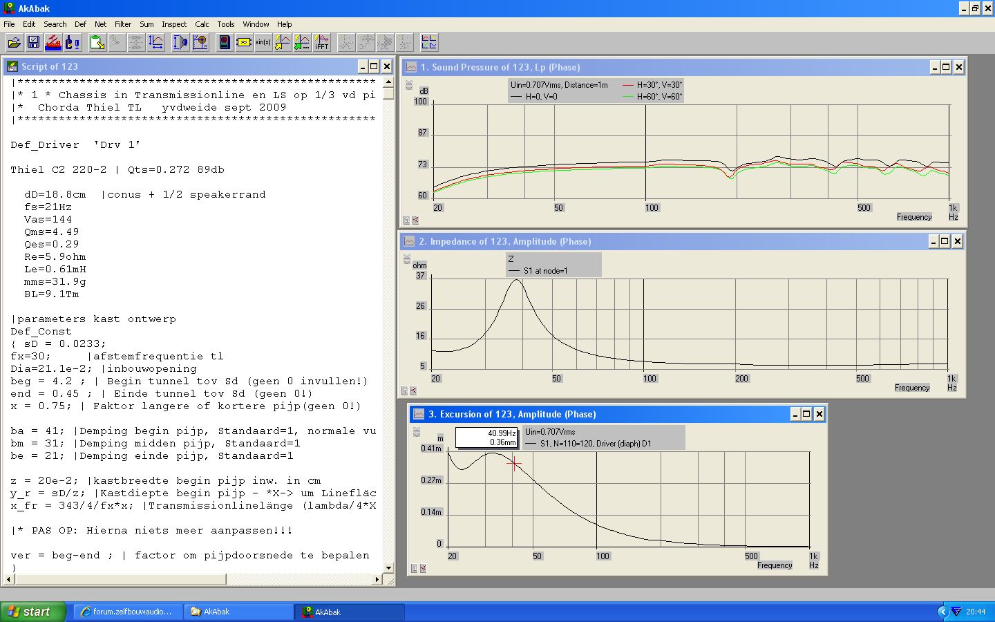

scipt Akabak tbv Chorda TL 1/10
|* 1 * Chassis in Transmissionline en LS op 1/3 vd pijp
|* Chorda Thiel TL yvdweide sept 2009
Def_Driver 'Drv 1'
Thiel C2 220-2 | Qts=0.272 89db
dD=18.8cm |conus + 1/2 speakerrand
fs=21Hz
Vas=144
Qms=4.49
Qes=0.29
Re=5.9ohm
Le=0.61mH
mms=31.9g
BL=9.1Tm
|parameters kast ontwerp
Def_Const
{ sD = 0.0233;
fx=30; |afstemfrequentie tl
Dia=21.1e-2; |inbouwopening
beg = 4.2 ; | Begin tunnel tov Sd (geen 0 invullen!)
end = 0.45 ; | Einde tunnel tov Sd (geen 0!)
x = 0.75; | Faktor langere of kortere pijp(geen 0!)
ba = 1; |Demping begin pijp, Standaard=1, normale vulling met "sonofil"=20
bm = 1; |Demping midden pijp, Standaard=1
be = 1; |Demping einde pijp, Standaard=1
z = 20e-2; |kastbreedte begin pijp inw. in cm
y_r = sD/z; |Kastdiepte begin pijp - *X-> um Linefläche am Lineanfang vorzugeben,
x_fr = 343/4/fx*x; |Transmissionlinelänge (lambda/4*X)
|* PAS OP: Hierna niets meer aanpassen!!!
ver = beg-end ; | factor om pijpdoorsnede te bepalen
System 'S1'
Resistor 'Rg' Node=1=2 R=0.5ohm |Generator resistance
Driver 'D1' Def='Drv 1' Node=2=0=110=120
|Kast definitie ------------------------------------
Duct 'Du_r1' Node=180 Len={x_fr/10} HD={z*1} WD={y_r*beg} visc={ba}
Duct 'Du_r2' Node=180=190 Len={x_fr/10} HD={z} WD={y_r*beg-((y_r*ver)*0.1)} visc={ba}
Duct 'Du_r3' Node=190=210 Len={x_fr*0.174} HD={z} WD={y_r*beg-((y_r*ver)*0.2)} visc={ba}
Duct 'Du_D1' Node=120=210 Len=2.5cm dD={Dia} | Chassis op 1/3 van de pijp
Duct 'Du_r5' Node=210=220 Len={x_fr*0.09} HD={z} WD={y_r*beg-((y_r*ver)*0.3)} visc={bm}
Duct 'Du_r6' Node=220=230 Len={x_fr*0.09} HD={z} WD={y_r*beg-((y_r*ver)*0.4)} visc={bm}
Duct 'Du_r7' Node=230=240 Len={x_fr*0.09} HD={z} WD={y_r*beg-((y_r*ver)*0.5)} visc={bm}
Duct 'Du_r8' Node=240=245 Len={x_fr*0.09} HD={z} WD={y_r*beg-((y_r*ver)*0.65)} visc={bm}
Duct 'Du_r9' Node=245=260 Len={x_fr*0.09} HD={z} WD={y_r*beg-((y_r*ver)*0.75)} visc={be}
Duct 'Du_r10' Node=260=280 Len={x_fr*0.09} HD={z} WD={y_r*beg-((y_r*ver)*0.85)} visc={be}
Duct 'Du_r11' Node=280=290 Len={x_fr*0.09} HD={z} WD={y_r*beg-((y_r*ver)*1)} visc={be}
|TL-opening ---------------
Duct 'Du_iv' Node=290 Len=0.1cm HD={z} WD={y_r*beg-((y_r*ver)*1)} |QD/fo=1.5
|Afstraalgedrag TL opening ----------------------------
Radiator 'Rad1' Def='Du_iv' Node=290=0
x=-95cm y=-50cm z=0 HAngle=0 VAngle=90 |plaats pijp opening
Radiator 'Rad3' Def='D1' Node=110=0
x=0 y={-x_fr/3} z=0 HAngle=0 VAngle=0 |plaats woofer

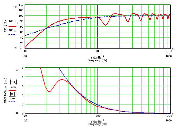

plaatje met simulatie 1/10 tapsheid MJ King tabellen ca 92 liter netto inhoud
pijp lengte 175 cm !!!

1/10 tapsheid nog een poging
1/10 tapsheid
1/10 tapsheid
Berichten: 33825
Re: Chorda TL
ziet er goed uit, denk dat die piekjes irl er niet zullen zijn, zeker met een beetje tactisch geplaatste demping (doe eens ba=20 (dus demping met een kwak sonofil aan het begin van de lijn)). en doe eens een plaatje met de membraanuitwijking

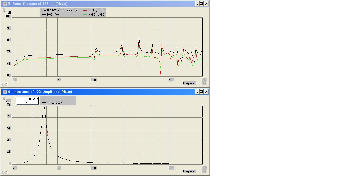

hm.. kan ik doen.. plaatje membraamuitwijking.. moet ik even zoeken..
weet jij wat voor funktie dat ook al weer was??
ben nog even met een ML TQWT aan het simuleren geweest
dat wordt niks kast van meer dan 200 liter !!!!!
Henkjan kan jij een simulatie met mathcad van MJ King doen
1/10 of 1/11 tapsheid ??/

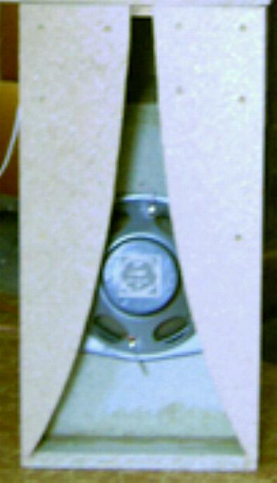

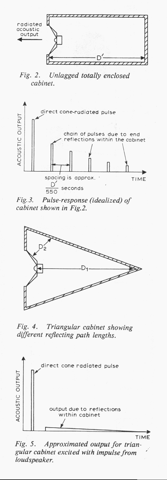

Zit me net af te vragen in hoeverre de tapsheid van pijpdoorsnede
het midden gebied "kan" beinvloeden..
meen mij te herrinneren dat Tony Gee een constante doorsnede
met zijn 2 weg Tl ontwerp losser vond klinken dat de tapse tl...
helemaal ideaal zou een driehoekige vorm zijn
voorbeeld

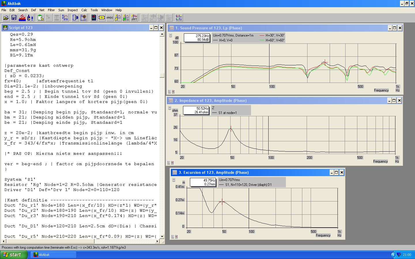

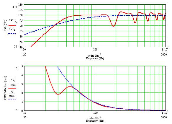

bij deze dan

Zo, even wat ontwerpen doorgevoerd in Ajhorn.
Bedankt voor je inbreng Sietse, ik acht ervaring niet lager dan de beste simulatieprogramma's.
Het is juist mijn bedoeling met dit topic om achter de gemeenschappelijke waarheid te komen, de overeenkomst tussen de programma's. Mijn ervaring met het ontwerpen van TL's, en specifiek de Chorda, was dat een zeer mooie simulatie in de praktijk erg tegen kan vallen. Gelukkig heb ik even eerder in de link naar de hoorns kunnen lezen dat Roland wel goede overeenstemming vond tussen simulatie en praktijk.
Omdat niet elk programma met dezelfde opties werkt zijn er veel verschillen. Misschien ontstaan 'tussen de parameters door' de interpretatieverschillen. Daarom is ervaring net zo relevant, in het ontwikkelen van een TL alswel in het werken met simulatieprogramma's.
Ik laat nu zien wat er gebeurd wanneer ik de Akabak simulaties in Ajhorn invoer.
De Akabak invoer, alleen kom ik uit op 95 liter en een hogere afstemming, 28Hz - de pieken/dalen zitten op andere frequenties
De gemodelleerde simulatie, met een 2,1 meter lijn komt de afstemming beter overeen (28Hz).
Een gigantische offset - 95cm komen de pieken/dalen meer overeen - in een kast van 92 liter
(800-80 cm2)
De gedempte lijn gemodelleerd, nu 1,6 meter om de afstemming en pieken en dalen weer overeen te laten komen met Akabak simulatie. De offset is nu 30 cm
De zuivere Akabak 1/10 invoer over de basreflex Chorda heen.
Heb ik eens gedaan; een tetraeder met 4 4"basmids... Das dus een piramide met 4 vlakken - gelijkbenige driehoek 3d dus.
Daarbij zat elke luidspreker onder een hoek van 60 graden t.o.v. een andere. Dat zou theoretisch erg goed moeten zijn. sommige MC luidsprekers zijn bijvoorbeeld ook ontworpen met dit idee.

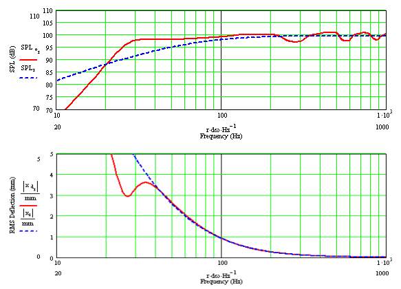

Berichten: 33825
Re: Chorda TL
zo, ff wat in mathcad gegooid.
beginnen we met het K+T recept, dus afgestemd op 20Hz en oppervlakte van de lijn=Sd
mooi vlakke afval. wel wat deuken, met wat extra demping in het gesloten eind wel wat te dempen maar helemaal wel krijgen lukt niet. of je dat gaat horen is de vraag.
dan de sterk tapse variant 1:11
dit is dus zoals eerder geplaatst op basis van de MJK allignment tabellen. Dit wordt dus een enorm diepe kast met een achterlijke hoeveelheid demping in het gesloten deel
tot slot nog een kortere K+T variant, afgestemd op 28Hz
dit is dus conform het plaatje dat ik eerder geplaatst heb.

Berichten: 9198
Re: Chorda TL
Zo... ook even uitgeplozen....
Alle respect voor DB, maar sommige dingen heb ik mijn vraagtekens bij.
De radius voor het tussenschot, de verdeling van de gaten, de gelijke diameters - die mij niet wijzen op helmholz filtering... dus toch gewoon een geperforeerd schot??
Bron: http://www.woebking.net/cms/index.php?o ... &Itemid=63
This is a TL based enclosure which uses reactive acoustic filters instead of fiber absorber. This gives a better low end response, with a higher gain as compared to other TLs using fiber absorber. Fiber absorber is used to dampen the higher resonances inside the line. But, at the same time it reduces the amplitude of the fundamental. Reactive acoustic filters, however, have a certain frequency band in which they operate and therefore they don't interfere with the fundamental frequency. By this way, you have a better sounding TL with a better low end response. This enclosure ensures such an operation in two ways. The first one is, it uses reactive acoustic filter to reduce the amplitudes of high resonances inside the line. The second one is that, there is a rear chamber right at the back of the speaker unit. The rear chamber also works as a filter. Rear chamber absorbes the mid frequencies which leaks to the line. As a result of this, only the frequencies, which needs to be in the line, enter the line from the back of the speaker unit.
Bron: http://www.yildiz.edu.tr/~ilkorur/ILKORUR/AER.html
Dat zal dan de IHA zijn, wel op een aparte plek. De lengte resonantie in de kast(hoogte) komt blijkbaar niet voor in deze TL :?: :roll:
Dat is dan het gedempte deel. Naar mijn idee is dat geperforeerde schot niet zo exact uitgekiend en is dit gewoon een TL start met demping, erg handig achter de luidspreker die nu een 50 cm verschuiving heeft waardoor resonanties minder heftig zijn - fundamentelen minder aangezwengeld worden.
Klopt dit een beetje? Geen kritiek op het ontwerp hoor, alleen wil ik het begrijpen.
