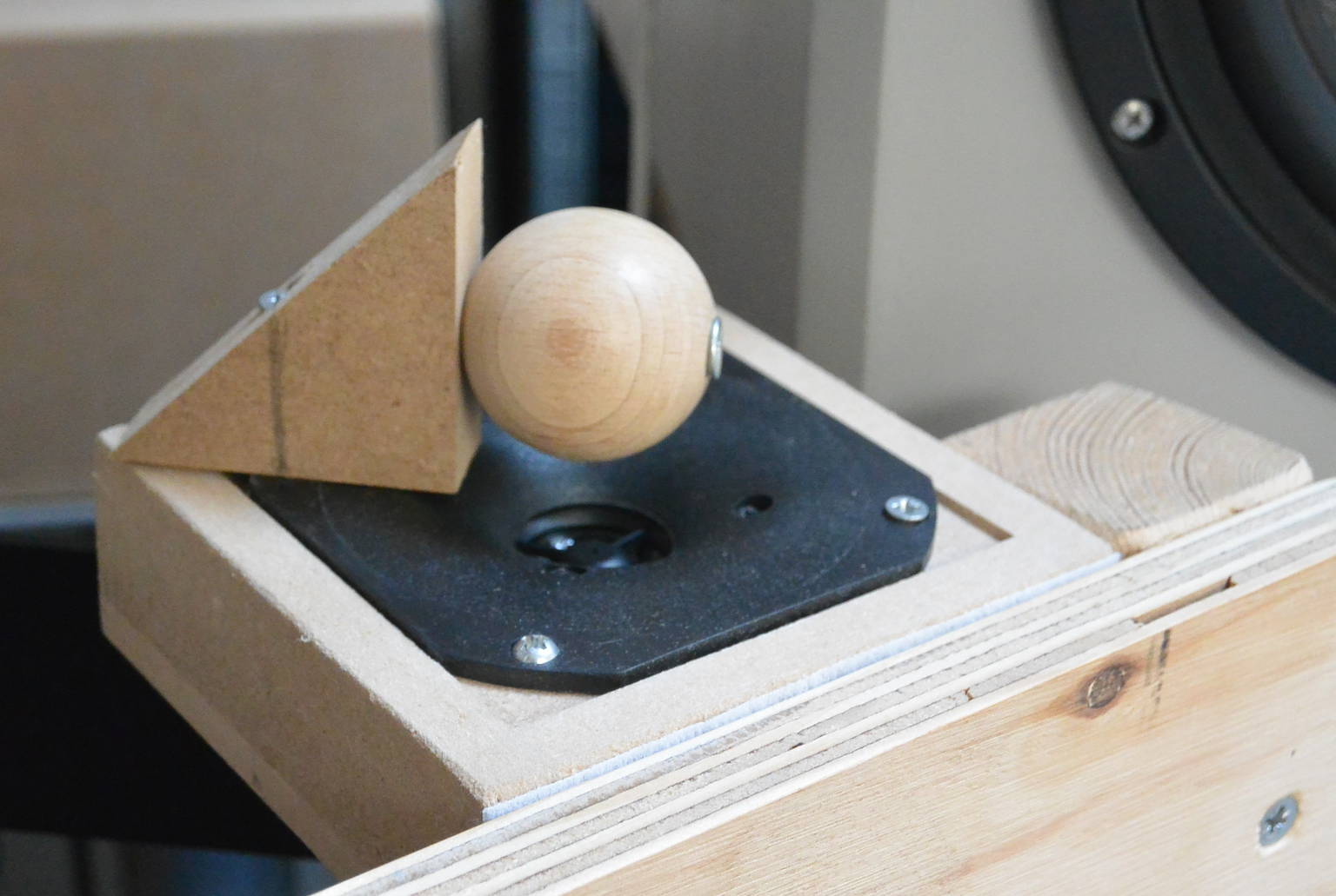

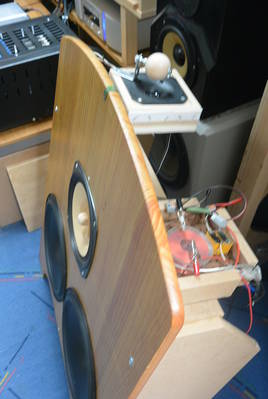

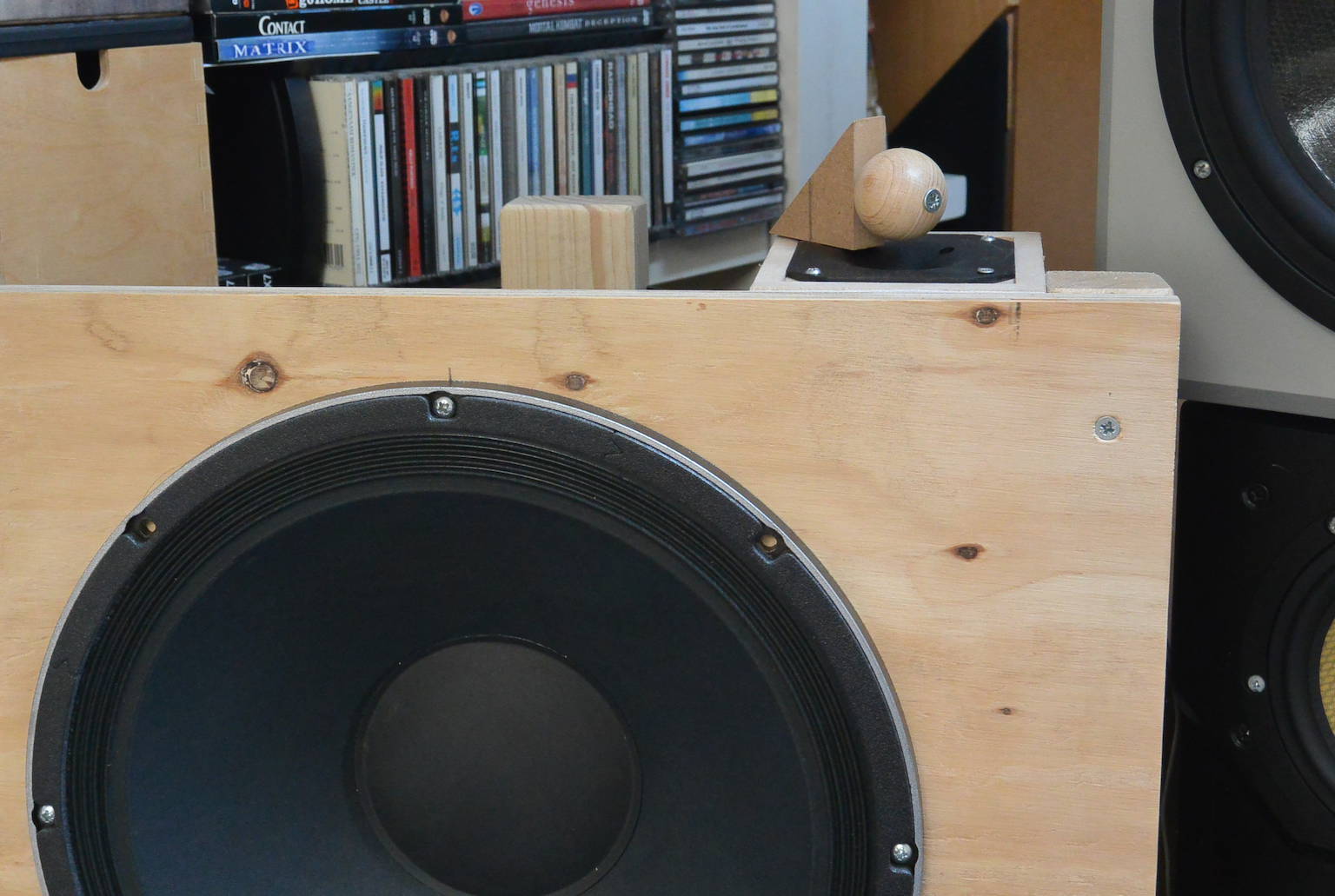

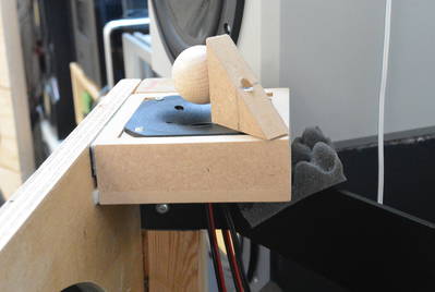

Dit net gepost op Facebook.
Dus hier ook maar een keer.
Het tilt mijn set naar een (veel) hoger niveau.
Some pics of my new 3D 2I (3d image improver).
It's an add-on for the Trio15Neo Lowther DX3 Leonidas XO.
This is still a proto type.
Gives much more air in the soundstage.
Better imaging and 3D experience.
For this moment fixed XO to go with the DX3.
Will be flexi later on !!
Hope you like.
A mate of mine , listening over here last wednesday , said :
I'm shocked and amazed at the same time. I was thinking , this set is about the best there is but this gives so much more joy !!
If I order a Trio set at PAP ; you HAVE to build me a set of these !!
It's not a tweeter thingy , but it's about room acoustics. The fr starts beaming at some freq. Your ears need reflections from the back and rear wall , to have the illusion of spacial sound. So I let the tweet do some "side" and "back" reflecting to fill in the psycho-acoustic gap. Just do it by ear til everything sounds OK to me. For the moment : single series cap 2,2 uF = ~8~10 kHz. If tweeter would beam straight at my ears it would count up on , the already rising , fr curve of the fr unit. So I try to guide the tweeterhighs to left and right. (in short , there is more to it.)
So ; between Lowther and Neo's I wave them together in the CSD's .
Between Lowther and tweeter I do this 3D.
It's the same idea.
Also thinking that OB development is in need for more 3D or 4D thinkers and designers.
It's very different from all other things I designed. But it's a lott of FUN !!
en straks de bijbehorende foto's.
mvgr. Leon.

"3d image improver" klinkt een stuk sexyer dan een ambient tweeter
maar werkt (zeker in gedempte ruimtes) wonderbaarlijk goed

Tja Henk Jan , als je lang genoeg met commerciële mensen optrekt ga je vanzelf fancy namen bedenken !!
(Ik ben ook wel Star Wars fan !)
Tis niet helemaal ambient trouwens.
Best lang moeten experimenteren om de goede coherence te krijgen !!
mvgr. Leon.

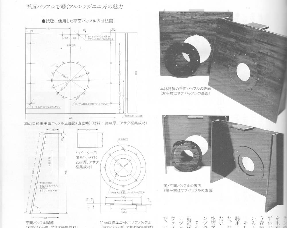

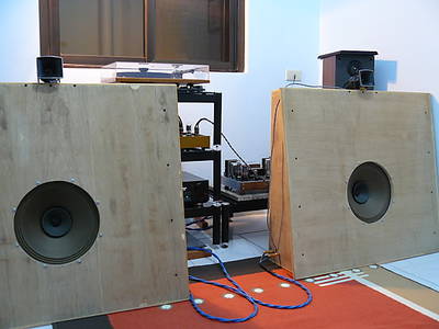

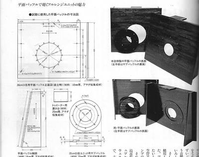

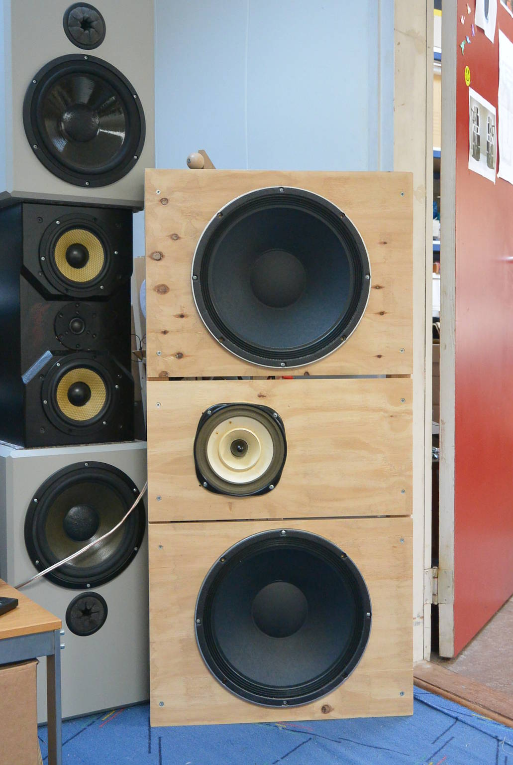

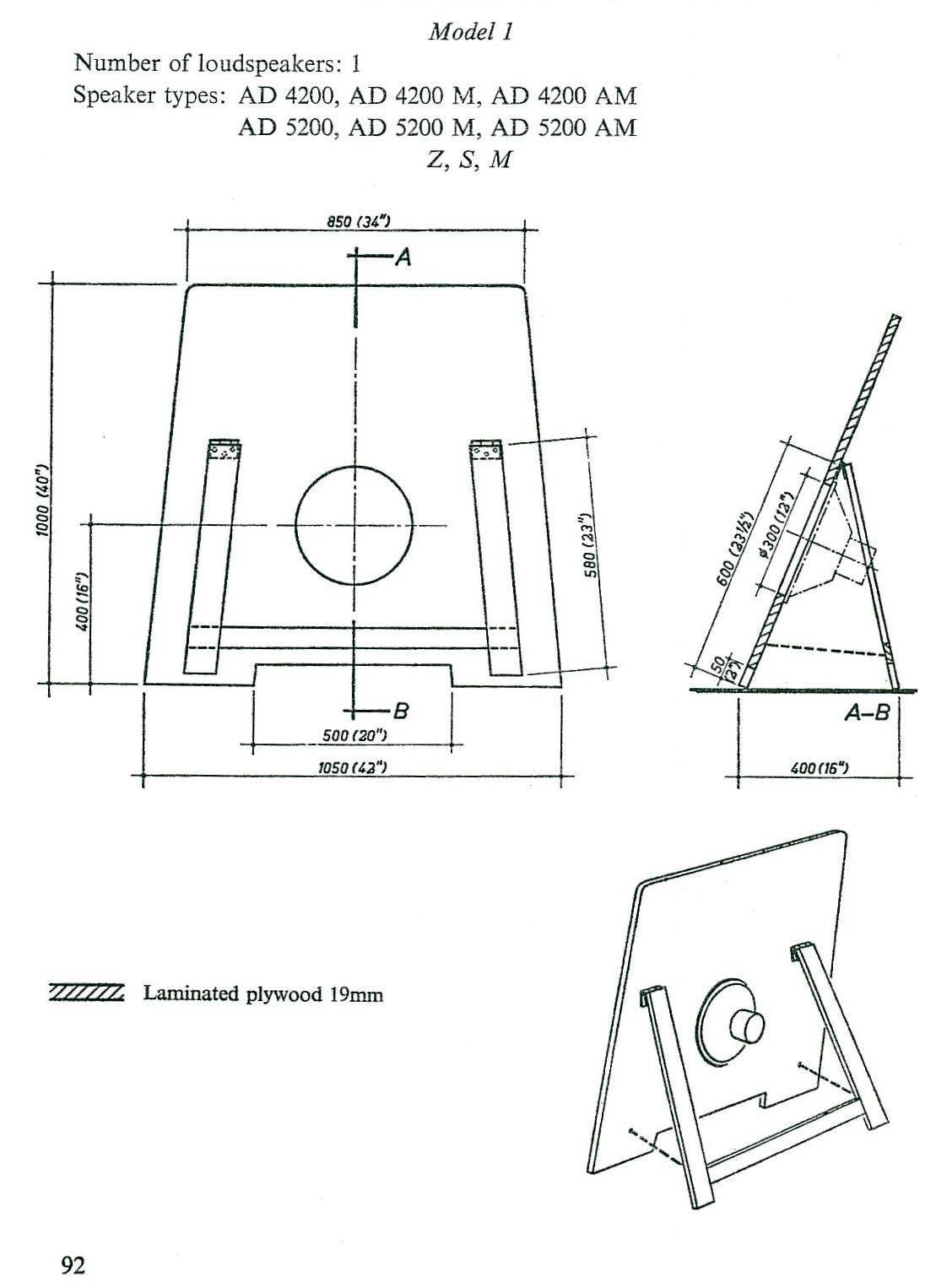

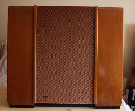

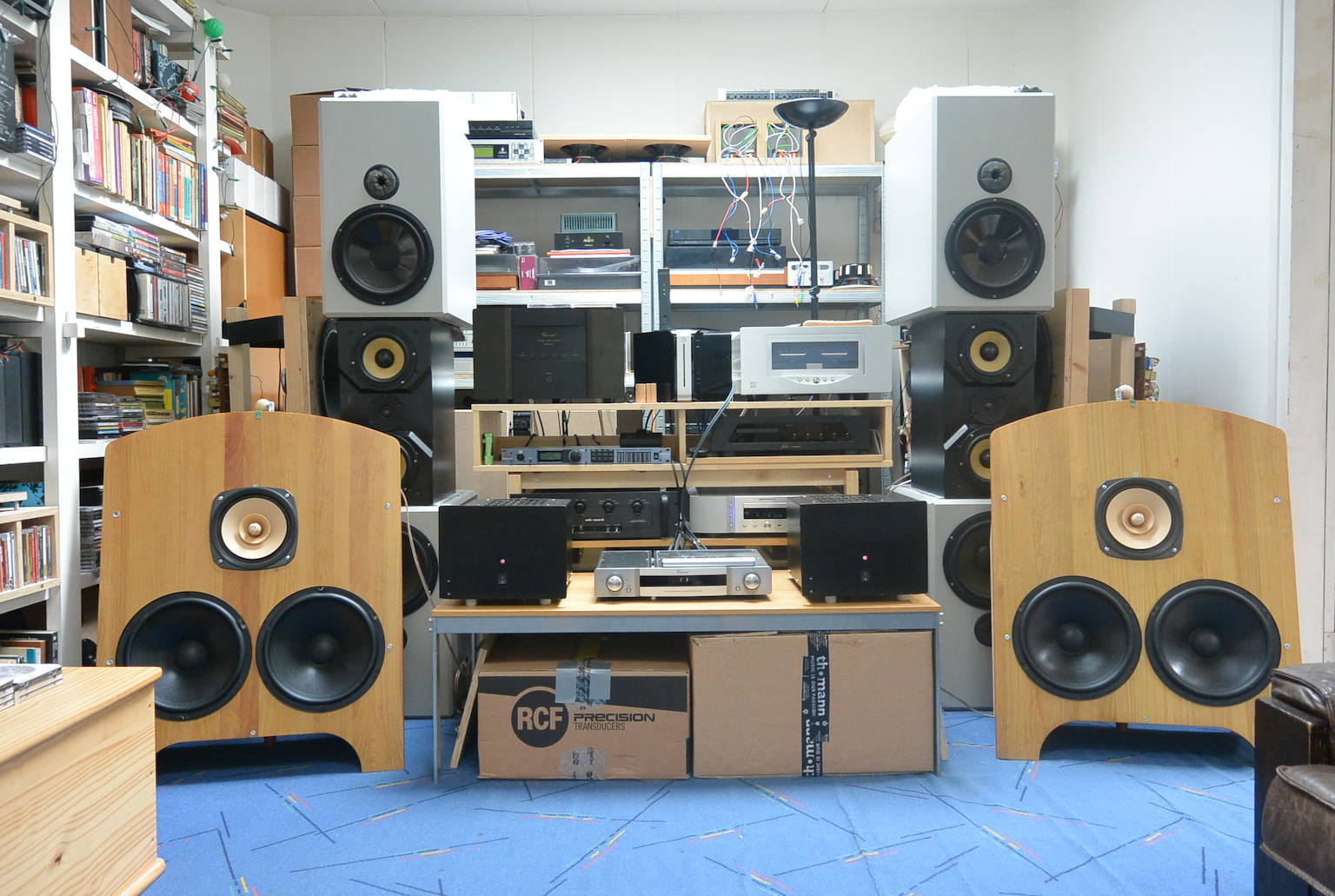

Even een kleine update.
na , nu ongeveer , een half jaar met de units van PAP te hebben gewerkt , heb ik het een en ander bijgeleerd.
wilde wel weer zelf eens iets ontwerpen , from scratch .
De eerste resultaten zijn er.
Voorlopig maar eerst wat foto's en de toelichting komt dan later wel.
Eerst waardoor ik toch wel geïnspireerd ben.
De ontwerpen van vroeger toen er nog geen DSP bestond.
JE labs , Philips , Wharfdale enz.
Afgelopen maandag mijn woofers binnen gekregen.
Ze zijn 12 inch en hebben , de voor mij , goede TSP's.
Ik heb nu de Trio15 set , en de kleinere set (2x 10 inch) van PAP.
Ik vond dat ik te beperkt aan het werken was omdat ik hun maatvoering moest aanhouden.
Dus nu gekozen voor 2x 12 inch en eigen maatvoering.
Een soort van Retro OB , als het ware.
Ben niet over een nacht ijs gegaan.
Alles zou moeten kunnen werken met een ZEN XO.
Ik wil zeker ook nog een "sinecap" ZEN gaan testen.
Hopelijk heb ik niet weer 400 metingen nodig en , kom ik , door eerdere ervaringen wat sneller tot een resultaat.
Doelstelling is om voor 25% van de kosten 95%+ van het geluid van de Trio15 set te bereiken.
Kan dus nog leuk worden deze zomer !!
Woensdag en donderdag eerste probeersel in mekaar gezet.
De woofers kunnen nu inspelen.
Anders even op mijn Facebook pagina kijken als je meer wil weten of......nog even geduld hebben ; er komt nog wel een langer verhaal.
Misschien open ik wel een apart topic als er interesse voor is ?
mvgr. Leon

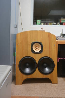

HOI René ,
Tis leuk om te doen.
Jij hebt mijn oude groene kastdeuren nog gehoord ?
Dit is een kinderbedje ; kop en voet stuk.
Soort van recycling
Dit is duidelijk smoother dan zo'n Lowther setup.
Ook lekkerder voor Rock enzo.
Zo'n kogeltje boven een tweeter doet wonderen.
Als je bij een FR unit de tweeter in hetzelfde vlak zet heb je erg veel XO onderdelen nodig.
De meeste FR's gaan oplopen naarmate de freq. stijgt.
Maar gaan tevens bundelen.
Wat je dus nodig hebt is opvulling links en rechts en NIET optelling on axis !!
Op deze manier werkt het als een trein.
Je moet het gewoon een beetje 3D bekijken dan zie je het in een keer !
Vind het wel grappig ; 3 OB sets.
Je kunt horen dat het familie van mekaar is maar ze hebben ook allemaal hun eigen ding.
mvgr. Leon.
