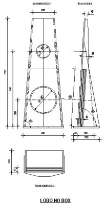

foto
test no box
test no box

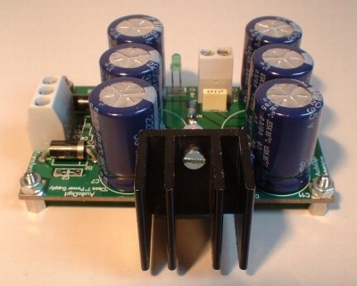

dit bedoel ik lees maar
Class-T-PSU-m
Any "good quality" 12 Vdc power supply is good for the Class T Amp 2020 or 2024. But what does "good quality" means?
In general any stabilized power supply with sufficient output current capability will do. You need at least 3 Amperes, but 5 is better. You need also "clean" and "lowe noise" power, and possibly a "very low output impedance".
Here most common power supplies will fail.
They are designed to be low cost and to supply smaller circuits. Even "professional" power supplies, which look so powerful and strong at first sight, will influence negatively the sound of the amplifier, they were not specifically designed for audio use.
Class T Amp power supplyThat's why we decided to design and sell our own supply, specifically trimmed for the Class T Amp 2020 kit.
Its main features are:
* Fully stabilized, with current and thermal control
* designed for the Class T amplifiers
* Very low noise, very clean: uses "schottky fast recovery" diodes instead of the noisier bridges, which will induce high frequency harmonics into the power
* Hight output current capability
* Pre-configured for 13.7 Vdc output, just the best for the Class T Amp
* Very low internal impedance: low ESR capacitors, and many of them in parallel ....

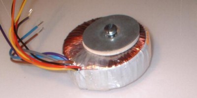

* Easy to use: just add a 15 + 15 Vac transformer , possibly toroidal, 30 to 50W
We think that this supply is the right complement to our Class T Amp, and will allow you to get the best sound you can get from it.
plaatjes
voeding
voeding
trafo 2 x 15 volt
trafo 2 x 15 volt

ZO.... gisteravond de T amp voeding getest... foto volgt :)

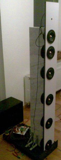

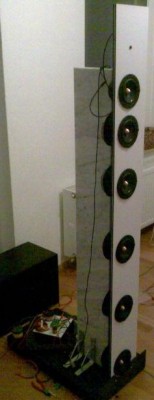

vond nog een mooi OB idee
6 fr's op een natuursteenplank
1.60 m hoog en 0.20 m breed
aan de achterzijden midden achter de units
haaks erop nog een plank ???
wat is de funktie hiervan ?
op de bodem een filter bsc ?
Of zou het een 2 weg systeem zijn ?
Speakers lijken mij van Supravox.... toch :)
of CSS.... hmm

Berichten: 33830
lijkt er op dat die plank er gewoon is zodat de handel kan blijven staan 8)

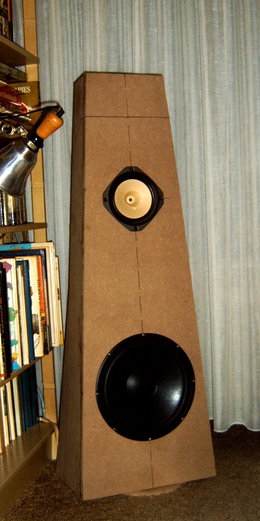

Binnenkort maar eens een definitief ontwerp maken
Hoogte blijft 1.20 m WAF is OK :)
Vleugels tpv breedbander inkorten :)
1 Peerless als woofer is bij mij ruim voldoende
Hoofdframe opbouwen van 12 mm berkentriplex
Onderste deel van de baffle opbouwen in lagen
12 mm berkentriplex
dik hardboard
12 mm spaanplaat
dik hardboard
12 mm spaanplaat
Zal binnenkort wel een tekening maken :)
plaatje is altijd veel duidelijker
Het concept van de fullrange vanaf 200/300 hz wil
ik zo houden.... dus geen tweeter :)
wil de rust in de weergave van een puntbron in het midden en hoog
gewoon zo houden... met klassiek doet de Fostex FE 167 E
het heel natuurgetrouw.... natuurlijk zet een tweeter het hoog wat
dikker "aan" en ietsje meer detail maar ik mis het niet...
De testkast hou ik zo om een andere FR speaker
te proberen...
CSS FR 125 SR of TB W3-871S (kan ik wel even lenen)
Verder zit ik de denken aan
Fostex FE 127 E (ook mooi volgens mij)
of misschien nog mooier de Omnes Audio BB 3.01
weidok
Berichten: 2570
Locatie: Dokkum
Bericht door weidok »
tekening LoBO NoBox :)
plaatje
weidok
Berichten: 2570
Locatie: Dokkum
update
maten in mm
maten in mm

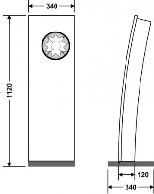

He ... Manger op Open baffle..
breedbander vanaf 100 hz
dus mooie basunit erbij :)
plaatje
Foto Swing met Manger unit
Swing tekening
Swing tekening
