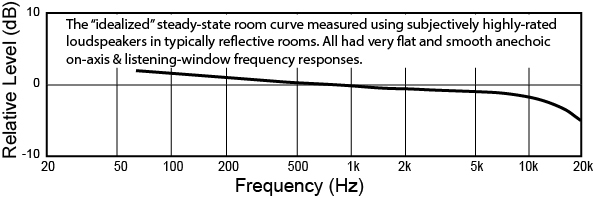

Almost 50 years of double-blind listening tests have shown persuasively that listeners like loudspeakers with flat, smooth, anechoic on-axis and listening-window frequency responses. Those with smoothly changing or relatively constant directivity do best. When such loudspeakers are measured in typically reflective listening rooms the resulting steady-state room curves exhibit a smooth downward tilt. It is caused by the frequency dependent directivity of standard loudspeakers - they are omnidirectional at low bass frequencies, becoming progressively more directional as frequency rises. More energy is radiated at low than at high frequencies. Cone/dome loudspeakers tend to show a gently rising directivity index (DI) with frequency, and well designed horn loudspeakers (like the M2) exhibit quite constant DI over their operating frequency range. There is no evidence that either is advantageous - both are highly rated by listeners.
Figure 12.4 in the third edition of my book shows the evolution of a steady-state "room curve" using very highly rated loudspeakers as a guide. The population includes several cone/dome products and the cone/horn M2. The result is a tightly grouped collection of room curves, from which an average curve is easily determined. It is a gently downward tilted line with a slight depression around 2 kHz - the consequence of the nearly universal directivity discontinuity at the woofer/midrange-to-tweeter crossover. I took the liberty of removing that small dip and creating an "idealized" room curve which I attach. The small dip should not be equalized because it alters the perceptually dominant direct sound.
It is essential to note that this is the room curve that would result from subjectively highly-rated loudspeakers. It is predictable from comprehensive anechoic data (the "early reflections curve in a spinorama). If you measure such a curve in your room, you can take credit for selecting excellent loudspeakers. If not, it is likely that your loudspeakers have frequency response or directivity irregularities. Equalization can address frequency response issues, but cannot fix directivity issues. Consider getting better loudspeakers. Equalizing flawed loudspeakers to match this room curve does not guarantee anything in terms of sound quality.
When we talk about a "flat" frequency response, we should be talking about anechoic on-axis or listening window data, not steady-state room curves. A flat room curve sounds too bright.
Conclusion: the evidence we need to assess potential sound quality is in comprehensive anechoic data, not in a steady-state room curve. It's in the book.
The curve is truncated at low frequencies because the in-situ performance is dominated by the room, including loudspeaker and listener locations. With multiple subwoofers is it possible to achieve smoothish responses at very low frequencies for multiple listening locations - see Chapters 8 and 9 in my book. Otherwise there are likely to be strong peaks and dips. Peaks can be attenuated by EQ, but narrow dips should be left alone - fortunately they are difficult to hear: an absence of sound is less obvious than an excess. Once the curve is smoothed there is the decision of what the bass target should be. Experience has shown that one size does not fit all. Music recordings can vary enormously in bass level, especially older recordings - it is the "circle of confusion" discussed in the book. Modern movies are less variable, but music concerts exhibit wide variations. The upshot is that we need a bass tone control and the final setting may vary with what is being listened to, and perhaps also personal preference. In general too much bass is a "forgivable sin" but too little is not pleasant.
