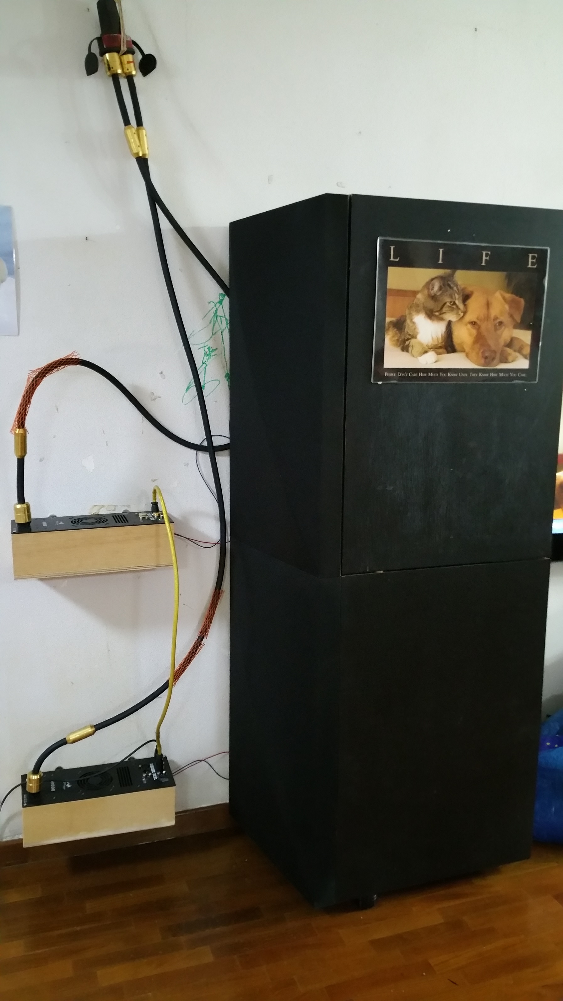

Time to close the loop.
I am very pleased with the purchase. And easy to setup too! At least for my usage.
As my main speakers is LR 4th order therefore it made thing easier.
I would see the set up as a three ways, i.e. full range, upper sub and lower sub.
All lowpass and highpass were LR 4th order, the only concern was matching the volume of the three ways. Done and happy.

I was lazy to pull out the gear for measurement. However, I listened to sweep from 20Hz to 300Hz, very pleased with the result!
The lowpass for the upper sub were between 80Hz and 120Hz, three presets. Highpass at 45Hz.
The lowpass for the lower sub was 45Hz too! One preset inverted, for comparison purpose.
Had set delay to the two subs closer to the listening position.
All LR 4th order, so phase wasn't an issue.

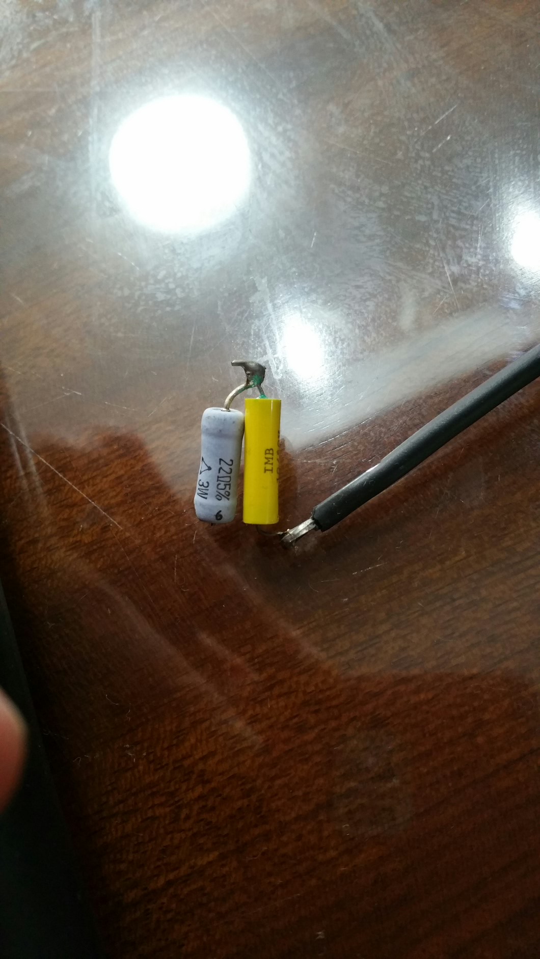

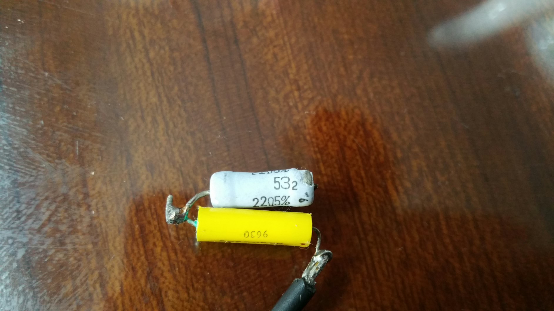

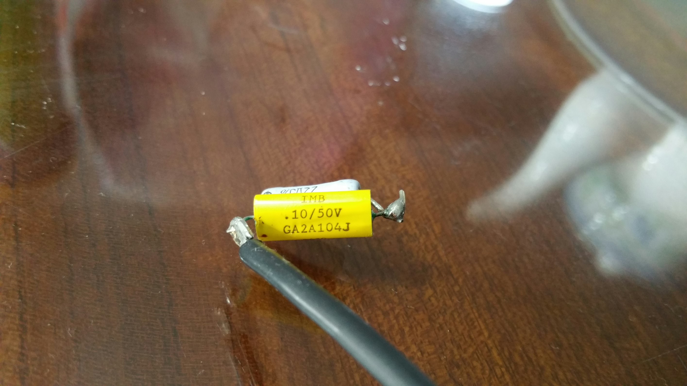

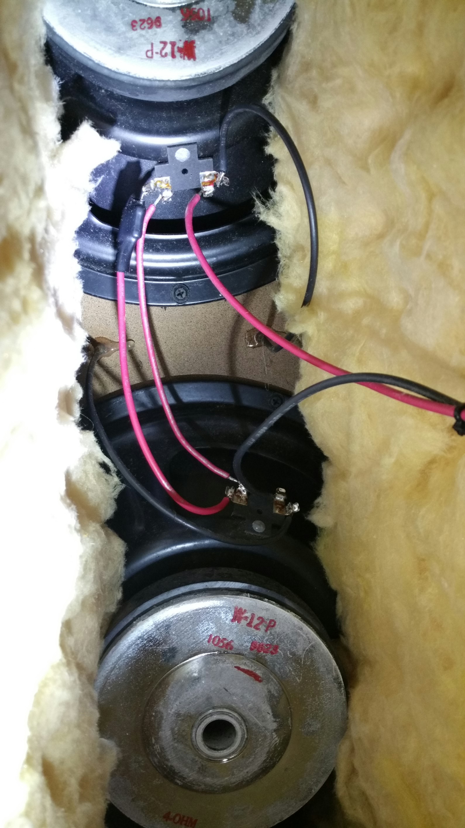

Can someone tell me what does the capacitor and resister (???) Between the two drivers?
How does it affect or improve the sounds?
TIA

It's to block high frequency.
In my application, can neglect it.
