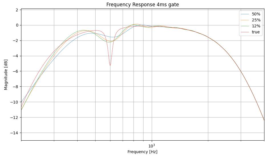

Dan Cyr schreef:
I did some quick investigation on gate width and gated windowing and its effect on measurement accuracy, especially at lower frequencies. It is often stated for example that if you gate at 4ms you have frequency resolution down to 250hz (the lowest frequency bin of the FFT of the impulse that is 4ms long will be 250hz). This is true, but there is little accuracy at even twice that frequency.
Different software seems to apply different windowing techniques to the gated impulse response, ARTA defaults to a rectangle (with Hann options), and I think REW and Omnimic use Tukey or Hann windows but I am not certain.
To investigate I made a simulated impulse of a minimum phase system with 4th order LR at 250 and 3000hz and added a sharp -5dB notch at 600hz.
The first plots shows the equivalent of two different windowing options in ARTA (Hann 25% and Hann 50%) the % indicates how much of the window is used for the roll-off. The frequency plots with "true" label are 100ms windows and match exactly the target.
As you can see it is really important to get longer windows, 4ms is not enough to capture much detail, and increasing the window to 50% hurts it further. I'm not finding much reason to use larger windows - it does help smooth response, but costs some resolution.

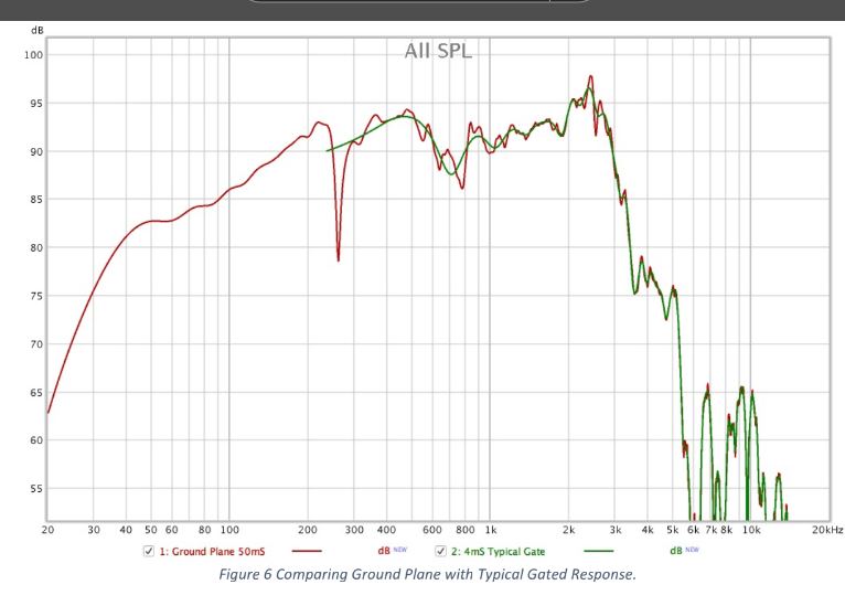

scott hinson schreef:
or those wondering if this actually has an application in loudspeaker design...
YES IT DOES.
I just went and pulled up my ground plane measurement paper, that has an example in that shows this happening in the real world with a speaker I was trying to design. It was a large PA two way speaker that had a huge pipe organ resonance for the port. Probably should have redesigned the port, but by that point we were too far along the process.
When doing the crossover the port issue was impacting the perceived tonal balance....so while I couldn't fix the port resonance in the crossover design, I could make it a bit less audible. But I couldn't have done that without having a really good measurement to provide the understanding of what the completed speaker system frequency response was.

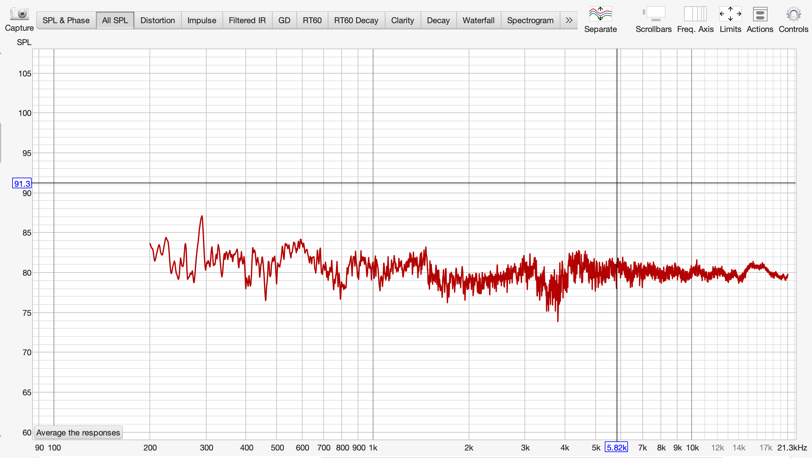

Weet er misschien iemand mij uit te leggen waarom er bij bepaalde gate tijden er een soort kamfilter effect optreedt aan de onderkant van het bereik? Ik denk dat dat te maken heeft met lekkage, maar snap nog niet helemaal hoe dat zit.
Ter illustratie twee keer zelfde meting uit REW, eerste met 500ms, tweede met 5 ms

Hoe ben je aan die 5ms gekomen?

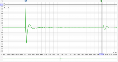

Bericht door satefan »
Het meetvenster dien je in te stellen door naar de Impulse Response van je meting te kijken. Daar kun je zien hoe vroeg/laat de eerste reflectie komt. Dat is de 2e impulse. Dit is bijna altijd wel de vloerreflectie (maar verschilt per meetsituatie).
Precies daarvoor stel je de rechterkant van de gate in. Zie onder:

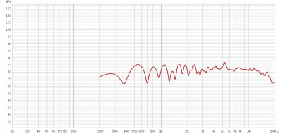

Als ik de rechter-marker voorbij de 2e impulse (dus de 1e reflectie) zet dan krijg je wat jij noemt het kamfilter effect:
Probeer de speaker hoger te zetten en minimaal een meter vrije ruimte rondom de speaker te hebben. Dan kun je redelijk mee uit de voeten komen.

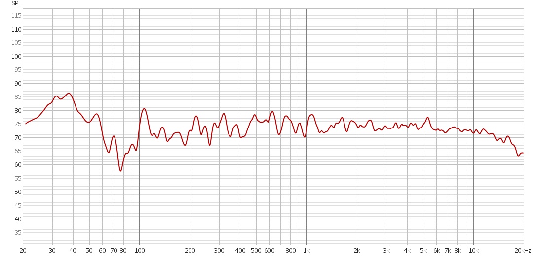

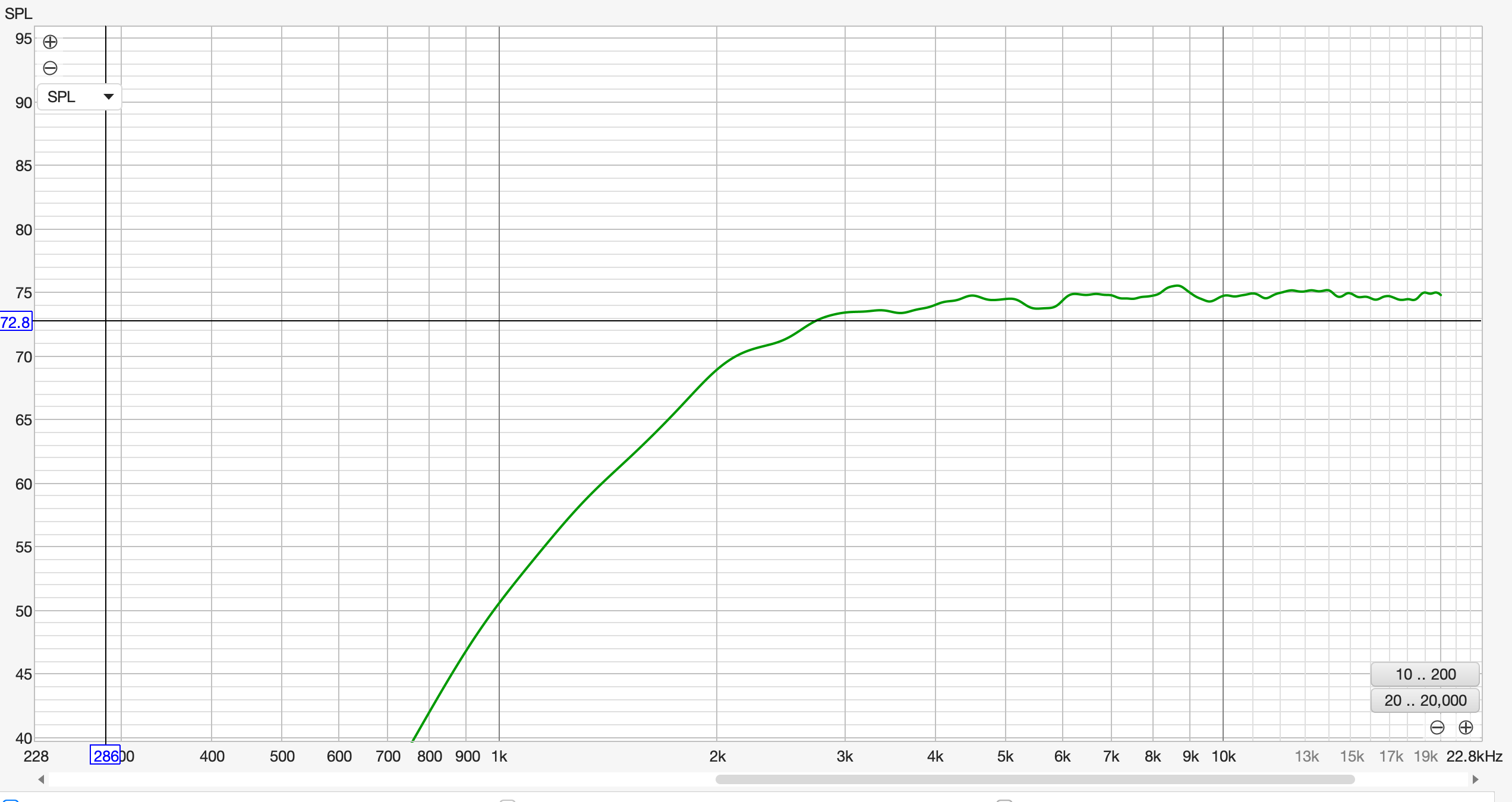

Hier dezelfde meting met de gate op 500ms:
Kun je wel weer smoothing toepassen, maar met een gate weet ik zeker dat ik alleen de speaker meet en verder niets. Voor lagere frequenties zou ungated en dan smooting toepassen wellicht een optie zijn?

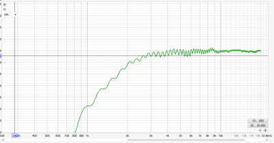

Nou nou, niet gelijk dramatisch doen. Dit is wat je ziet als de meetmicrofoon een meter vanaf de speaker staat in een kleine ruimte. Dan vliegen de reflecties je om de oren. Daarom dus een gate gebruiken en dan kan ik erg betrouwbare en reproduceerbare metingen doen. Gaat al jaren goed.
Als ik close-range ga meten en de gate op 500ms zet dan zie je dit, ook gewoon met een sweep:
Satefan
