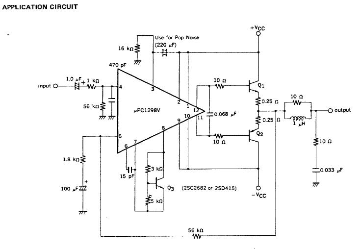

De LTP ed zit allemaal in de uPC1298V. Maar eerst de vraag dan of het de moeite waard is om dit aan te passen? Volgens onderstaande quote is het zeker de moeite waard. (dit zal ook zeker aan het ontwerp liggen, heeft dat hier ook nut?)
0 - 15mV: Damn good!! If you read '0V', you may have a capacitor output, or your meter is set wrong
16mV - 50mV: An acceptable value, especially at the lower end of this range. 2nd harmonic distortion is probably twice to four times what manufacturer's spec calls for at higher frequencies. Probably not audible, as the distortion is mostly in the upper octaves. At the upper end of this range I begin to raise an eyebrow.
50 - 85mV: Something is certainly amiss, and while this is not enough to put your speakers or equipment in jeopardy, the amp is running nowhere near where it should. I'd venture to guess that most of the DC-coupled amps that are in use by forum members here fall into this range.
100mV to ?: A high enough voltage will cause the DC protection to kick in. This happens at a level determined by the designer, but is usually equivalent to about a diode drop (600mV)or so. Needless to say, if you are listening to an amp with 100mV or more of DC offset, you have no idea what the amp really is supposed to sound like. Indeed, some amps without a differential input are actually designed to have a bit of DC at the outputs, but this is triple-rare, and I don't think anyone here owns one. (in my book it's piss-poor design, but if you can sell it WTH..)

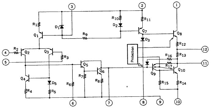

Equivalent schema uPC1298V

Check is of er tussen pin 5 en de gnd enkel een weerstand zit of dat er een weerstand en elco in serie staan, zoniet kan je die laatste plaatsen.
mvg Rudy

Juul, meet de dc spanningen is op pin5, pin4 en de uitgang.
Zelfs als match je de uitgangen niet, je amp zou met die elco dezelfde dc spanningen moeten hebben op alle drie de punten.
mvg Rudy

4: 0,2mV
5: 0,2mV
11: 1,36V
12: 1,08V
Dat lijkt me niet echt juist... V12-V11 moet 0 zijn lijkt me.
Misschien eens de pinnen 11 en 12 loshalen en dan meten? Dan weten we of het door het IC komt of de transistoren oid.
Als het het IC is heb ik pech want die is obsolete.
De opbouw lijkt verdacht veel op de application circuit van de sheet.

Wat niet klopt is dat je aan je verschilversterker geen dc hebt maar aan je uitgang wel, daar voor DC dmv die elco die spanning overal gelijk zou moeten zijn, daar zit ie der namelijk voor. Als dat niet is dan is de elco pleures, kan zijn dat ie kort ligd. ( of zijn er rare dingen aan de hand :D )
V11-V12 is te hard afhankelijk van de be overgangen en zijn enkel richtwaardes, maar op zich zijn die nog niet zo slecht, omdat in jouw aplicatie er nog drivers tussenzitten, dus die waardes zijn niet zo gek.
Maar als het dng nog muziek afspeeld en je instelstroom vrij goed in te stellen is dan s er daar niks mis mee.

Heb de versterker eens beter bekeken. De feedback ziet er anders uit dan bovenstaande schema. Er is een deel dat voor en achter de elco zit.
JuuL
Berichten: 2616
Lid geworden op: za 12 mar 2005, 16:38
Bericht door JuuL »
Dag Rudy,
Dit verklaart het een en ander.
Er wordt een deel meteen teruggekoppelt met de 220k weerstand. En het andere deel hangt onder de elco ipv erboven. Hoe kan ik dit het beste veranderen? De condensator en 180E van plaats verwisselen, 5k6 nemen voor de 220k en 100E en 5k6 verwijderen?
En welke waardes (versterking) zal ik nemen?

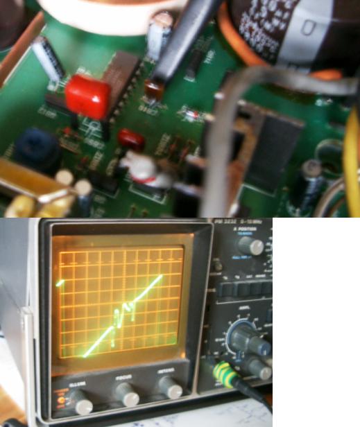

Ook ziet het condensatortje voor de clock van de SMPS er een beetje zwart uit, als ik meet (1:10) zie ik een rare slinger in het midden van de zaagtand, ook begint het signaal met een negatieve offset en gaat deze langzaam omhoog, waarbij de versterker steeds wat meer stroom trekt (tot zo'n 5Amp waar labvoeding afschakelt).
Ik zal deze ook vervangen.
excuses voor slechte foto's, de camera heeft geen goede macro stand.

Ik heb dit gedaan en de offset is verdwenen :D
Waarom hebben ze in eerste instantie niet voor deze setup gekozen? Mijn ruisniveau ligt nu wel wat hoger vogsmij, miss is dat de reden?

Condensator voor clock vervangen, nog steeds zo'n rare slingering. Ik ga een nieuw Upc494 bestellen.

Ik veronderstel dat je de 100E aan pin5 hebt gehangen ipv zoals op de foto :wink:
Normaal werkt hun schakeling ook prima hoor ( zelfs beter ), eventueel gewoon is alle onderdelen vervangen.

Kan de eindtorren wel loshalen. Ik denk dat ik eerst een nieuwe UPc494 moet monteren, want dat clocksignaal lijkt nergens op zo...

Ik heb Vbe van twee van de torren van de voeding eens met de scope bekeken. Dit lijkt er niet op! Geen mooie blokgolf, allemaal geslinger en gedoe. Daar is iets kapot, ik verdenk de upc494.
-edit-
Nieuwe bestelt, dan kijk ik wel verder :wink:

Ik heb het nieuwe IC gemonteerd, maar geen verandering.
Hoe kan die clock er nou zo slecht uitzien? :?
