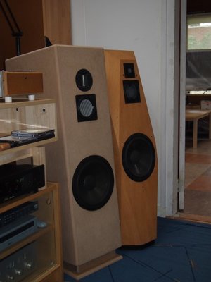

Re: de zoveelste Open Baffle
Het betrof deze set op de foto.
Eton 11 , accuton c 79 , en Fountek ribbon.
Het XO is van mijn hand uit de tijd dat ik nog alles zat te meten en te simmen.
mvgr. Leon.
mvgr. Leon.

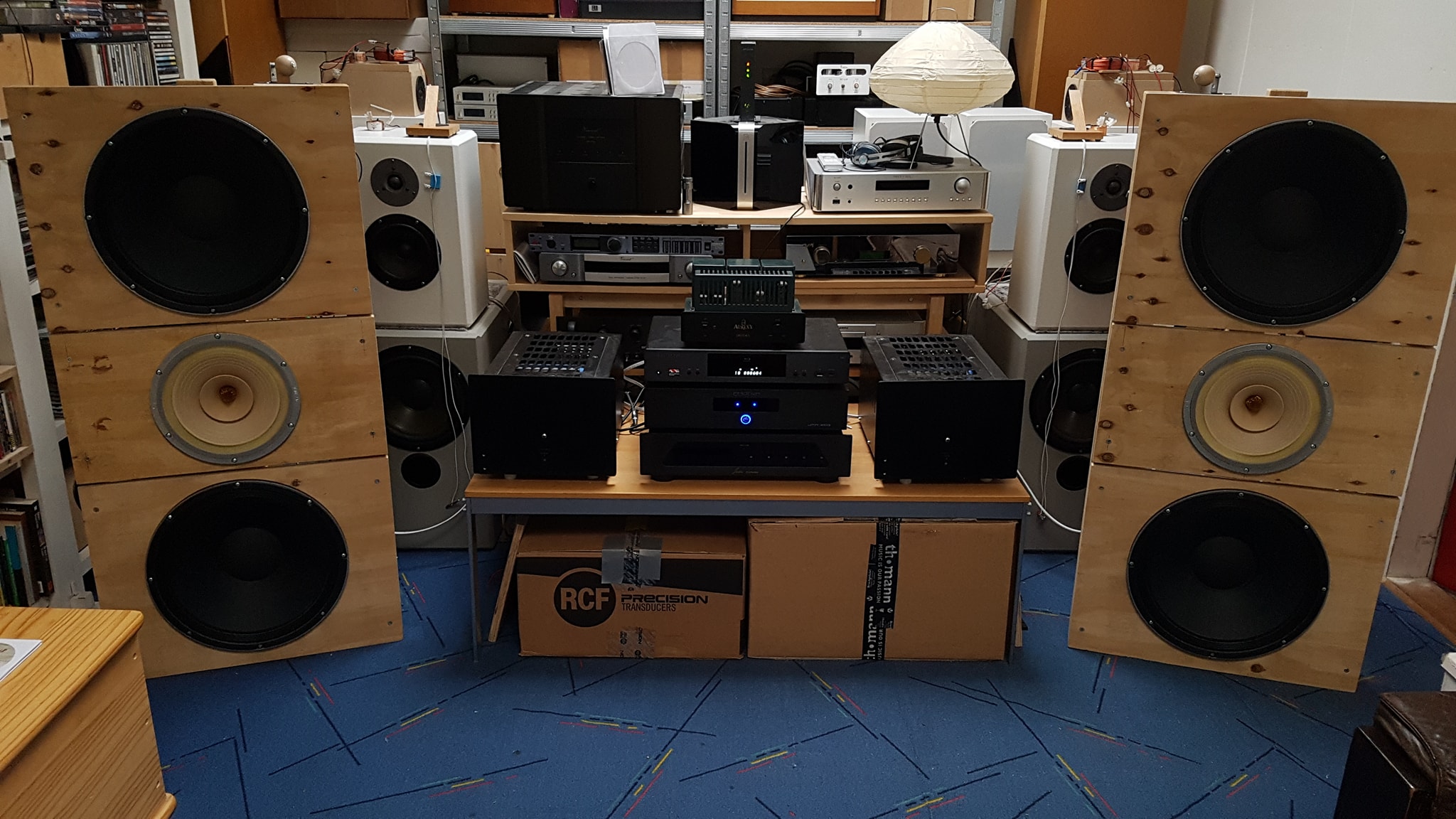

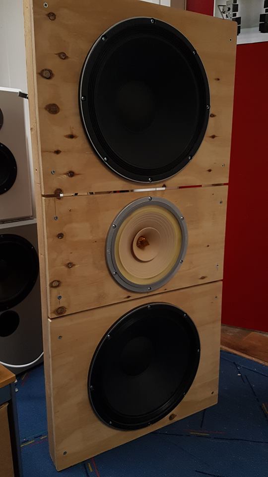

Afgelopen zaterdag , samen met Coen (Floeper) , zitten luisteren naar mijn voortgang met de Li-audio driver.
Voor de mensen die geen Facebook hebben , en toch deze reis willen volgen , heb ik even het commentaar gekopieerd.
So as you might have seen before, Leon and I are testing this Lii-audio 10" FR driver (Crystal-10) Toby Zhang. Today I sat together with Leon Huijgen to listen to them. As you see they are currently running in his PAP trio15 set-up with Leonidas XO (1 coil, 1 cap, L-pad).
We listend to this driver in different setups.
- FR (no XO, no Woofers), here you notice that you miss the feel of the bass! There truly is bass with the ~30Hz resonance rating, you can hear it's there, but we want to feel it. Therefor we are going to test tgis driver in a JE labs OB as well, with or without XO. (To be continued)
- Trio15 setup (no tweeter, no contour circuit)
This gives a very nice laid back sound (easy to the ears) but is missing that natural vibration in the mid area. Leon designed a contour circuit to tune this area.
- Trio15 setup (no tweeter, with contour circuit)
The clarinet and piano sound more natural, but the main improvement you could hear in male voices. In this setup the contour circuit definitely improves the sound (at least the way we like it).
- Trio15 setup (with tweeter and contour circuit)
With the horizontal tweeter add on (parallel with 1 cap and resistor) the entire system becomes more spacial, you get better imaging and a more spacial sound (more "live" feeling).
The highs are not playing louder or better this way! It's just complementing the soundstage.
We are very curious how these drivers will perform in the JE labs, so stay tuned for updates
